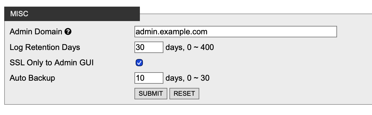

    I'm having trouble with the log retention period for my users.
    The period is set to 30 days as shown in the image.

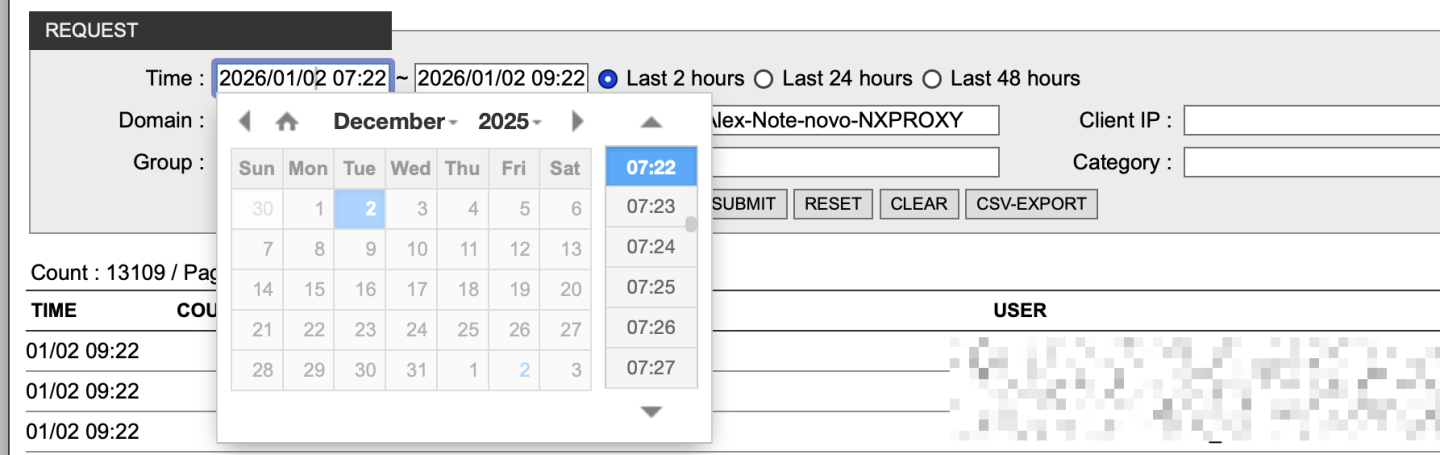

    But when I try to go back beyond 48 hours, it doesn't show me anything for any user. How can I solve this?

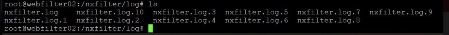

    Show me /nxfilter/log/nxfilte.log file. We need to see how many requests you get first.
      There are many files; which one do you want to view?

        Is this attached document sufficient?

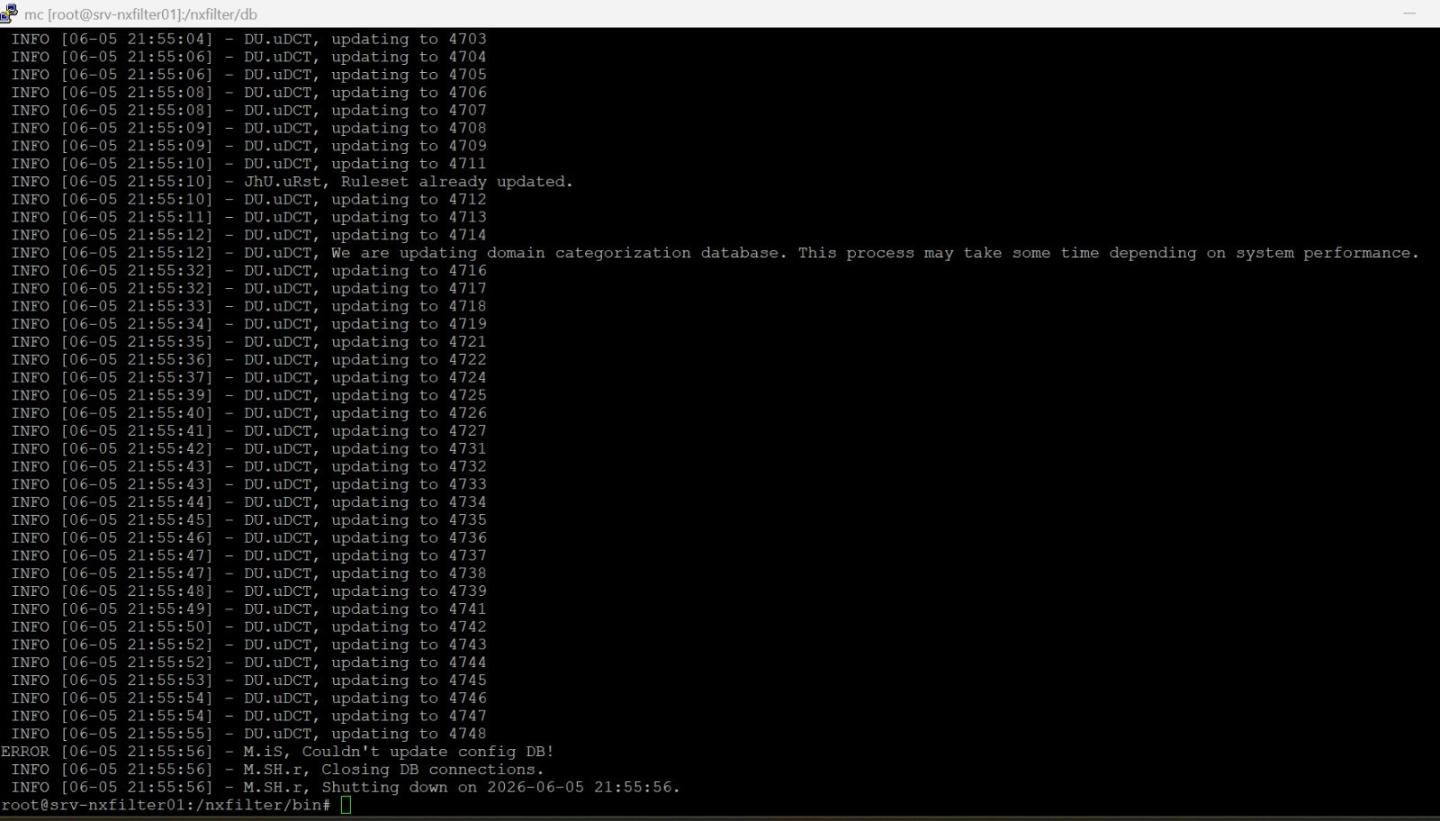

                It was not possible to update the NxFilter XXX version (Datacomex version) to a new updated version.
                The procedure performed for the update:
                Downloaded the file with the latest version of Nxfilter
                Installed the .deb package on the Nxfilter server
                Updated with the dpkg command
                After successful update, the program starts, and when it tries to update the Nxfilter database, it gives an error and the Nxfilter service crashes.
                A backup was also performed via the web panel, and the file was extracted and stored in the /nxfilter/db folder, but the same problem occurred, the service starts and then gives an error.
                Attached is a screenshot of the error.
                • #9
                  What's Datacomex version? If you send me the config db in /nxfilter/db or the backup file from System > Backup I can test it.

                        • #13
                          I tried to update it on my system. It updtaes without any problem. I have sent you the updated config db file. Try it.

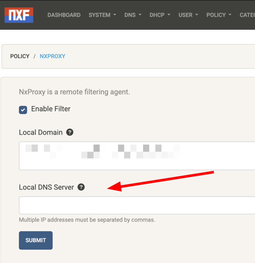

                            I’ve now updated to the latest version of NXFilter (4.7.5.4), but I’m facing a different issue.
                            I can only use the NXProxy agent on version 1.1.2, not the latest version (1.3.1). I’ve noticed that when I update to the latest version and reboot the workstation, web browsing is intermittent—sometimes it works, sometimes it doesn't. Similarly, rule-based blocking works sometimes but not others. It seems like there’s an inconsistency with this latest version, or perhaps a configuration is missing on my server?
                            According to AI, the latest version of NXProxy requires some additional server-side configurations—such as pointing to the local DNS—but I’ve tried that without success. Do you have any tips or a solution?

                              Local Domain and Local DNS Server are for when you use it in your local network. I don't think there's much difference between v1.1.2 and v1.3.1.
                              Look into its log file first. It's in C:/Program Files (x86)/nxproxy/log directory. And run this command in CMD:
                              Code:
                              nslookup porn.com 127.0.0.1
                              If you blocked 'porn.com', you will get your server IP as the response.
