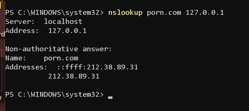

    Local Domain and Local DNS Server are for when you use it in your local network. I don't think there's much difference between v1.1.2 and v1.3.1.
    Look into its log file first. It's in C:/Program Files (x86)/nxproxy/log directory. And run this command in CMD:
    Code:
    nslookup porn.com 127.0.0.1
    If you blocked 'porn.com', you will get your server IP as the response.
    Hello.
    I am using NXPROXY agent version 1.1.2, and yes, I have pornographic content blocked.
    But then why does my browsing work when I update to an agent version higher than 1.1.2?

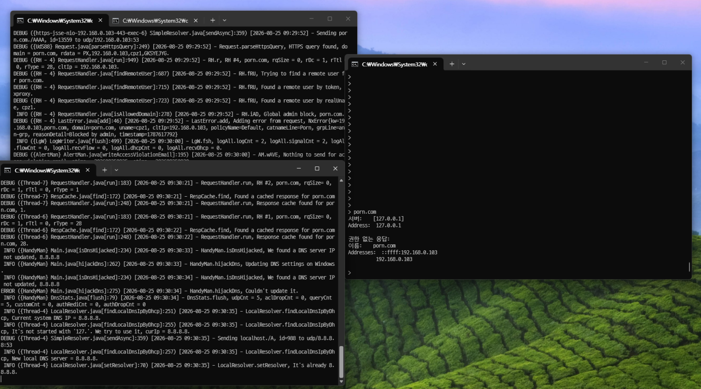

    • #17
      It works fine on my system.
      Look into the log file. Or post it here.
