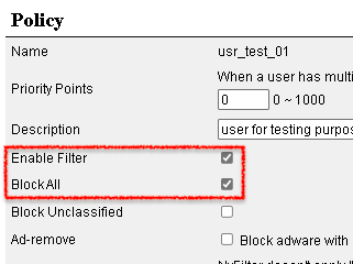

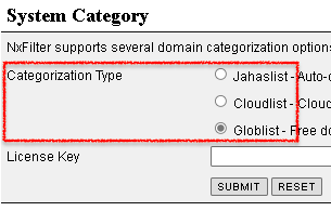

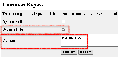

      I mean that if i set up "NXFilter" as shown in the following pictures:
Name:	Screen Shot 2021-11-19 at 16.20.00.png
Name:	Screen Shot 2021-11-19 at 16.21.12.png
Name:	Screen Shot 2021-11-19 at 16.21.47.png
      i well get restricted access to Internet (in this exemple - only to "EXAMPLE.COM" domain)

      My question: same behavior well be applied for any count DNS clients or only for 25
      • It will be working for all the users.
