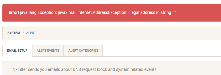

    Good morning Team, I am new using NxFilter, I was able to install it using the docker-image, and now I am trying to setup the configuration for the Alerts but I am getting an error.
    I am using a Microsoft 365 E-mail account for this; I have used the account for other applications, and I am able to send alerts E-mail with this account, so the problem is not the account.
    When I fill out the form
    and click on Test I receive this error. Can someone provide me guidance on this matter. By the way I updated the docker image to the lates version because I thought maybe that could be the problem, but the issue persisted. Thank you in advance.
    Did you save it? You need to submit and save it first.
    In old days, you could test it without saving it first. But we had some troubles with the library we were using in those days. After we changed the email library to a new one, we have to initialize it again after we change some params for the library. Means that you have to restart it before you test.
    Try to save it before you test.
    • alejandro
      alejandro commented
      Editing a comment
      Good morning, support200 thank you very much for your help, after saving the configuration I tested it and now it is working for me, I really appreciate you help. Have a great day.
    We may fix the problem with the next version.
    • support200
      support200 commented
      Editing a comment
      It's fixed by v4.6.9.3.
