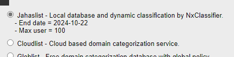

I have had it configured and not needed to manage the system in a while. There should be some kind of notification that the Jahaslist is due for renewal. Its a little frustrating for me not knowing...
how do I know when my Jahaslist is expired?
Thank you for the response, I turned them on and I get this... is that expired...
No. It's different I guess. 'Invalid license' means that it can't verify your license serial. It's mostly from your firewall rules. You need to open outgoing TCP/80 and UDP/123 for your NxFilter server.
To see if it's expired, go to 'Category > System'. There's your license info including the expiration date.
I just checked my firewall (cisco ASA) and I am allowing both tcp 80 and udp 123 but it is still complaining. But I can now see that my license has expired. in order to upgrade, I need the old license key, where do I find it?
Ok so I renewed 100 users for 3 years AND applied the license with a service restart. I set the alerts back on and I am still getting the invalid license.
