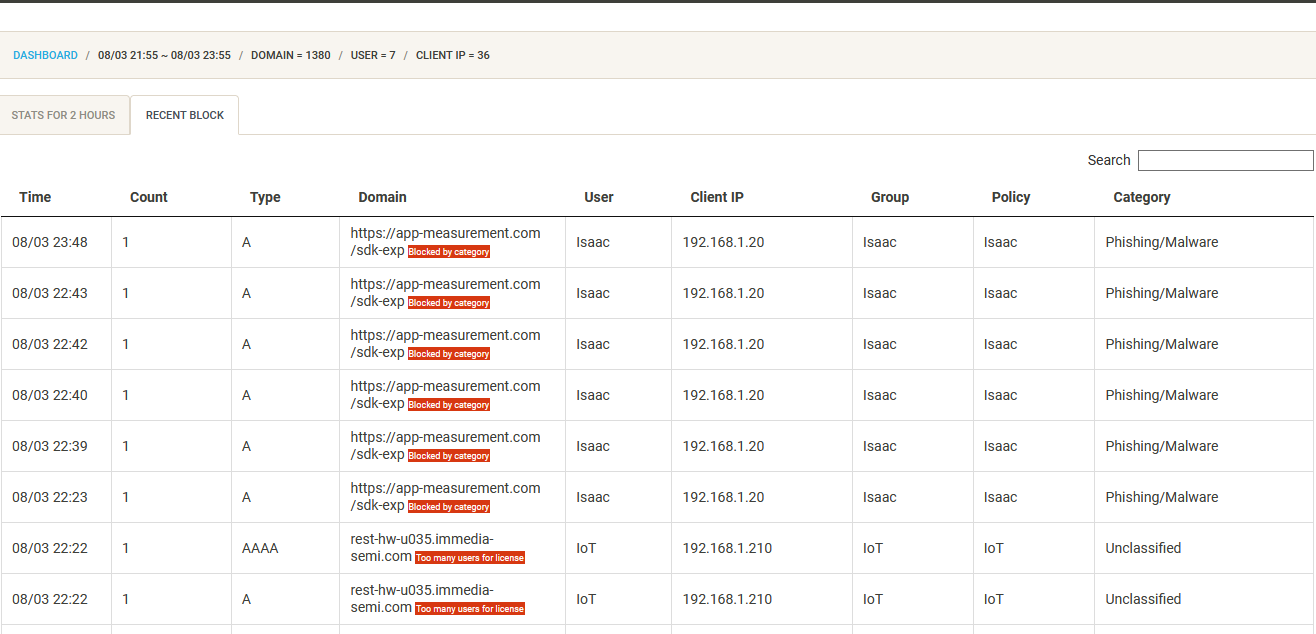

    In my NXFilter Dashboard, I I start getting an error message of "Too many users for license" next to filtered events.
    When this begins happening, I reboot the NXfilter server, and the problem seems to clear.

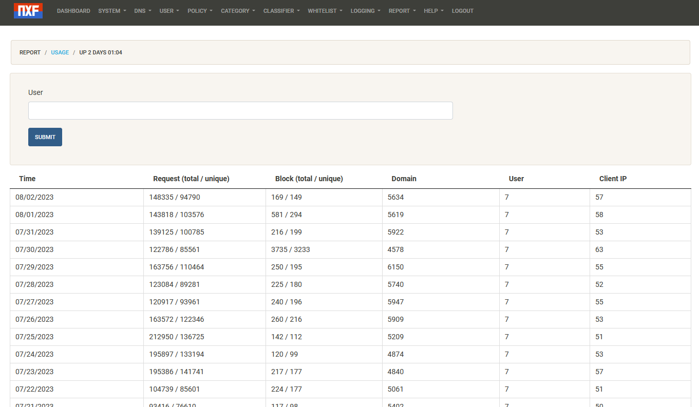

    If I check the report on Usage, I have the following:
    I use NXFilter at home, and have two networks. One is for the regular users on 192.168.1.0/25 and the other for IoT devices on 192.168.1.128/25. I have an NXfilter master server running in the first users network, and a slave running from the IoT network. The two are in sync, and running. When I get the "too many users" error, both show in their logs the message. Rebooting the master clears the problem.
    I didn't think I have too many users to exceed the license I have given the above.
    Do you use the free 25 user license for Jahaslist? If so, you have more than 60 users and that will make the problem. You can switch to Goblist.
      No, I purchase and renew a license each year for Jahaslist.

      The above excerpt from my log shows the license being loaded I believe.
        Send me your license serial at support@nxfilter.org
          We found your license. In our usage report, you have more than 60 users. You could see it on 'Report > Usage'. Your IP counts hits 63 recently. You have to increase the size of your license to 100. If you want to increase it, contact us at support@nxfilter.org.
