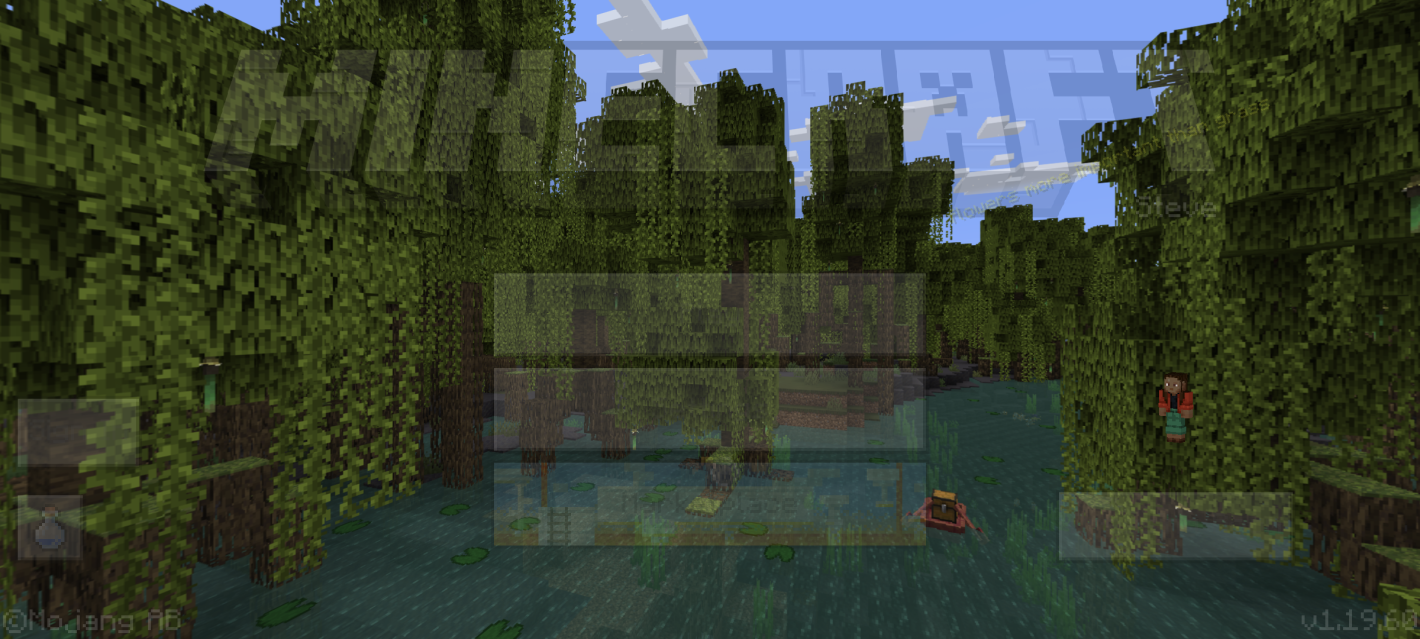

                • I'm pulling my hair out with this. I can't think of what on earth it could be... Once I change my DNS to point to my router it works. Change it back to nxfilter it doesn't.
                  • When I click on play this is what shows... It just stays at this screen with the music playing.Click image for larger version

                        • So I made the requested changes. I went ahead and ran a tail on the log and stopped and restarted NXfilter. I then went into MC on my phone and when I pressed play it ended up in the same spot...
