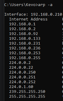

  • #16
    No device with same IP on my network

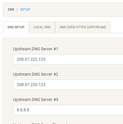

    • #17
      Current DNS settings on Nx

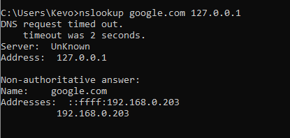

              Good morning and thank you for testing this.
              Here's an update from my side:
              • Tried changing my ip to static 192.168.0.210. Still having issues with nxfilter as DNS server.
              • Enabled debugging via logj4.properties file
              Debug showed these kinds of entries or similar:
              DEBUG [10-09 07:16:03] - Sending forcesafesearch.google.com./A, id=45714 to udp/208.67.222.123:53
              as well as users logged in via cxblock and data.
              • After enabling debugging and stopping and starting nxfilter nslookup nslookup gives same response
              What I am not understanding is why is 192.168.0.203 coming up as the server address for google.com?
              Anyway, within the DNS request logs in Nxfilter I can only see traffic from chrome from the nxfilter pc and the laptop I am testing with. The reason is that both are using cxblock.
              I am wondering why DNS filtering works through cxblock/nxproxy, but not when statically assigned.
              I understand what you are saying about tracing my UDP 53 traffic but I am not sure how I can do that. Any recommendations?
              Update: I am guessing the nslookup queries should be showing up on the logs in nxfilter. But none of that traffic is showing up, so I am guessing that it is not reaching nxfilter server.

                NxProxy and CxBlock uses TCP/443 to communicate with NxFilter. When you do regular DNS queries or use Nslookup, you send your queries through UDP/53.
                You have 192.168.0.203 as Block Redirection IP and 127.0.0.1 is not associated to any user. So, Login Redirection works and it gets 192.168.0.203 as an answer.
                127.0.0.1 works because normally there's no restriction for local traffic by anything mostly a firewall. But you have the same result even if you disable your firewall.
                If you don't see any traffic from your nslookup when you use 192.168.0.x IP as the server IP, it means NxFilter doesn't get any traffic through UDP/53. It's blocked somewhere before NxFilter.
                People uses something like Wireshark when they want to view network traffic on Windows. https://www.wireshark.org/download.html
