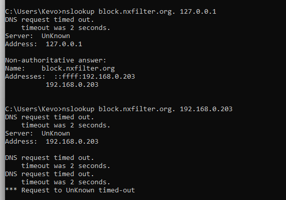

                If the first works and the second one not working, it may be a firewall issue. Did you install it using our EXE package?
              • Thanks for clariying.
                So this is interesting. Running nslookup via 127.0.0.1 times out briefly and gives a reply, but running nslookup via 192.168.0.203 gives no reply whatsoever

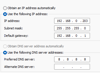

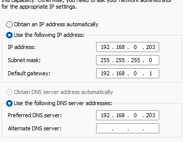

                        • Can you make it a static IP address then? You can change its IP as well to exclude the situation that you have a system having the same IP in your network.
                          • Are you asking me to change to an IP other than 192.168.0.203? Here are my current settings:
                            When I try using 0.203 as DNS I don't have connectivity.
