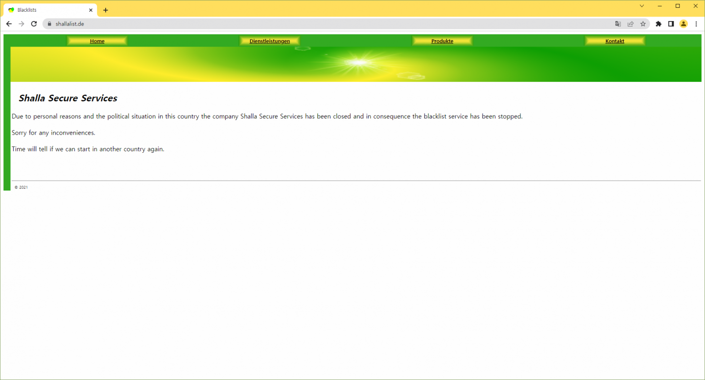

    Shallalist has gone already. They don't service it or update it. If you want a free option for domain classification, try Globlist with v4. It's also free.

      • Didn't I tell you that Shallalist has gone?
