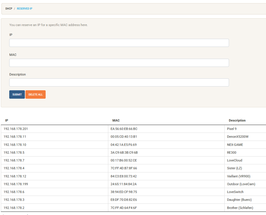

    I have a Raspi4 with Nxfilter connected directly via LAN-cable to a Router/Modem Fritzbox 7590. Now I want to turn off the DHCP service on my Fritzbox and let Nx do the job, but...
    Although the service is running on NX, the IP settings, including the statically assigned IPs, are entered, and there are no conflicts with other services and running DHCP, NX does not want to/cannot provide any end device with an IP!
    As soon as I turn off the DHCP service on the FritzBox, my home network goes down, meaning that all devices connected to the LAN and WiFi can no longer communicate with the internet.
    No devices appear under “Leased IP”!
    Restarting the end devices, the Pi with NXFilter, or the FritzBox did not help.
    Turning on/off the "Prevent conflict" did not help.
    Changeing the IP-Range for the DHCP didnt help.
    What works: Giving a Device a manual fixed IP adress (e.g. 192.168.201) , Gateway 192.168.178.1; DNS 192.168.178.9), put it with MAC-adress in the "Reserved-IP" menue and connect it via WiFi direct with the NXFilter! I have connection & internet, but cant see it in the "Lease" because it was not really getting a IP adress from NX-DHCP.
    I have tried all the standard solutions without success.
    Nx on Pi: 192.168.178.9
    FritzBox: IP 192.168.178.1
    NX DHCP NeX
    DHCP Reserved IP NeX

    Can anyone help me solve this?
    Many thnaks & regards
    NeX

              Hi & sorry for kinda spaming here, bute I did another test.
              I simply tried another DHCP server (isc-dhcp-server) on a trial basis, and with the following settings, the DHCP takeover worked immediately and without any problems after switching off the DHCP server on the FritzBox!
              So I conclude: I have no "direct" configuration problem, but a config problem with the DHCP-settings of NxFilter!

              nexus6@lovepi:/ $ sudo systemctl start isc-dhcp-server
              • #8
                Show me /nxfilter/conf/dhcp.properties file and then restart NxFilter and then show me /nxfilter/nxfilter.log file. If you don't want to post them here, you can send me those files at support@nxfilter.org.
