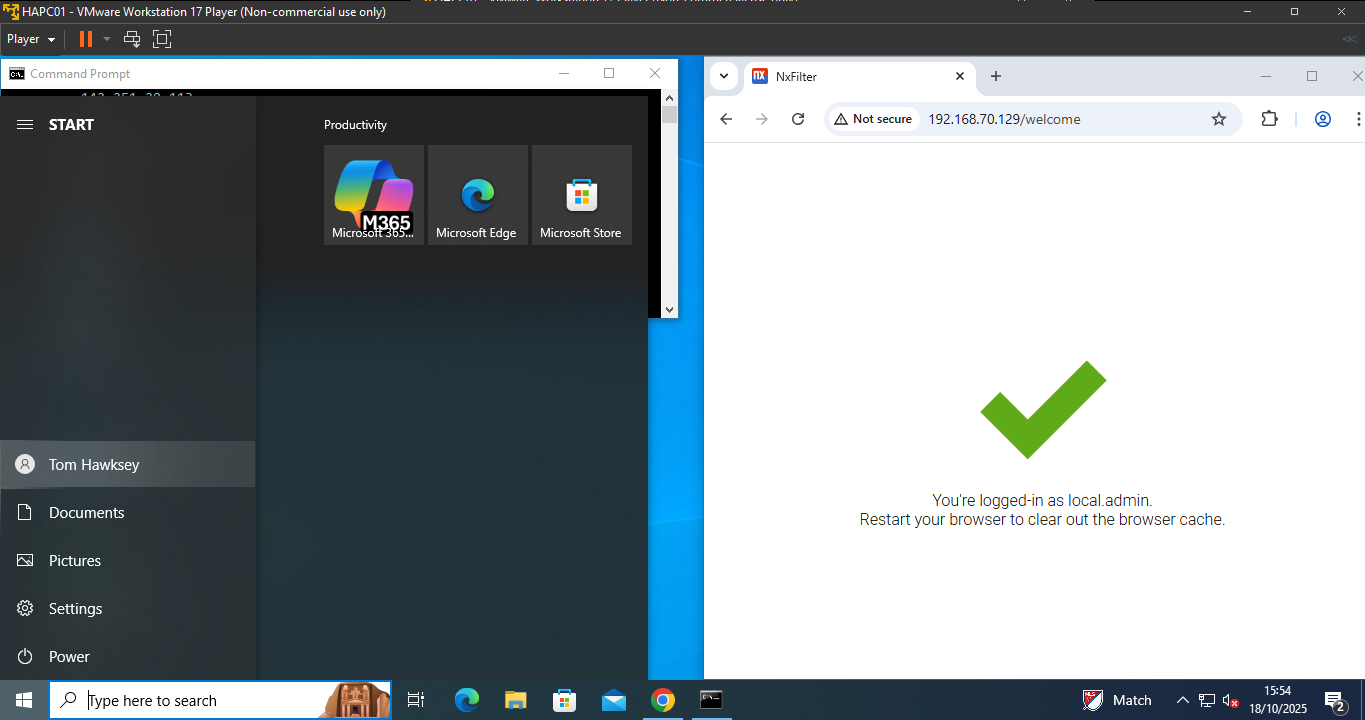

                      • How do you get the login page? NxLogon is running and you try to access google.com and you get the login page? In that case, it's weird.
                        Try to see the info displayed in http://your-nxfilter-ip/welcome while NxLogon running.

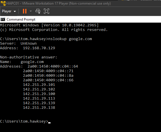

                        And send a DNS query using Nslookup: nslookup google.com
                        If you still get the NxFilter IP as the answer, then send me the lof files under /nxfilter/log.
                        • So (with NxLogon running) as previously mentioned, if i disable user authentication on the server then no login page is presented > enable it and theres the login page.
                          So in regards to the welcome page - see below

                          The user is different than the logged in user , for the nslookup - see below

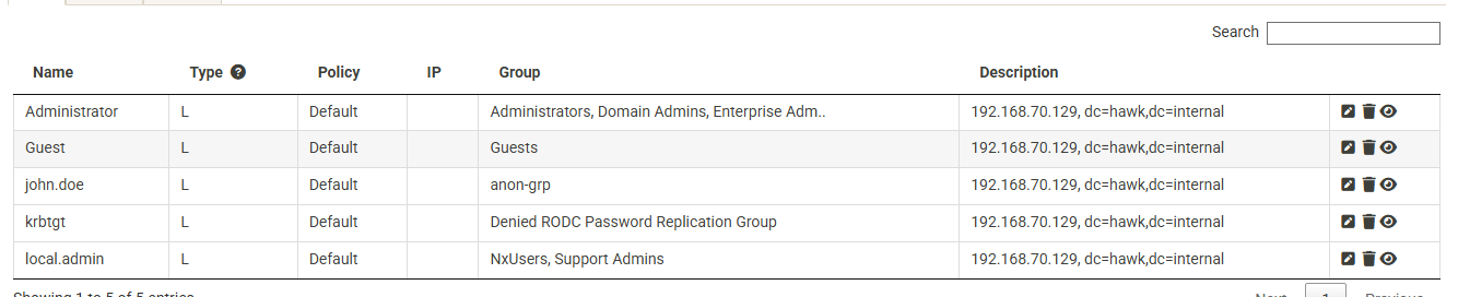

                          • So it's randomly started working without any changes being made, strange. However I will post a screenshot below as explaining things is not my strong-suit. But basically I have an AD security group which on NxFilter I have assigned a policy to, but users in that group do not have the policy enforced.

                            • In that user list, clict the Eye button. That's the test button to show the current policy for users. The Policy in the list is from the user property not from User - Group relations. The current policy is determined in a real-time way as there are many factors to decide which policy to apply. Mutiple groups and work-time and free-time..
