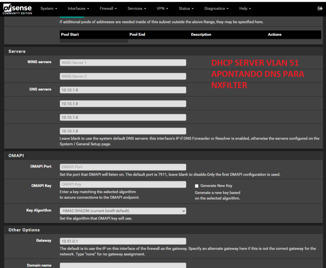

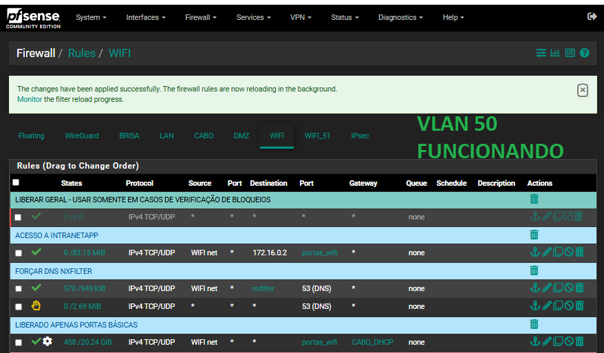

    I have a pfSense 2.6.0 server pointing DNS to NxFilter on Ubuntu Server, but I have a VLAN 51 that is WiFi for clients. When connecting, they are not redirected to the pfSense Captive Portal page, but if I remove the pointer to NxFilter, the Captive Portal page appears for clients.
    On other VLANs that do not use Captive Portal, it is working normally.
    My network:
    pfSense: 10.10.1.2 (VLAN 1)
    NxFilter: 10.10.1.8 (VLAN 1)
    Administrative: 10.50.0.0/24 (VLAN 50) - working
    WiFi: 10.51.0.0/23 (VLAN 51) - not working with Captive Portal

    Which DNS server the VLAN50 use?
      VLAN 50 is also using NxFilter DNS (10.10.1.8)... but it doesn't use Captive Portal; only VLAN 51 uses Captive Portal.
      Both VLANs (50 and 51) are pointing DNS to NxFilter, but only VLAN 51 isn't working.
