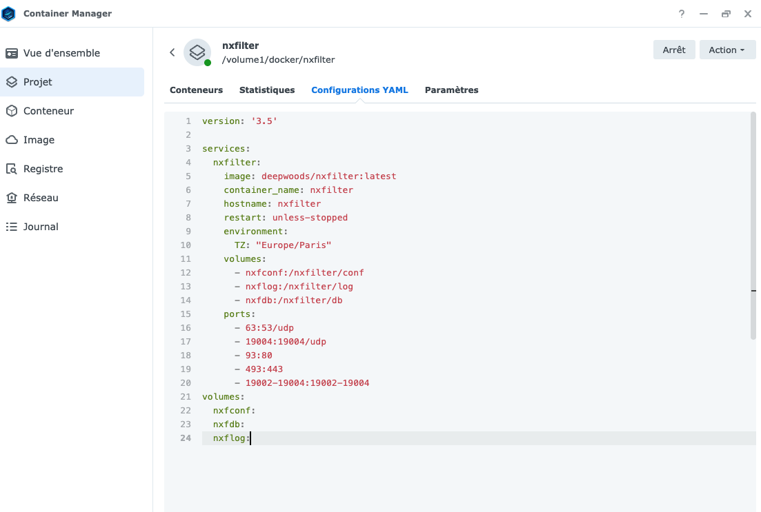

      Hello, thank you for your answer. I've already tried to do this, but even if I force volume creation under docker, I get the impression that nxfilter chooses its own volume, and it's impossible for me to access it with DSM.
      Here's my compose file:
        We don't have /nxfilter/data and /nxfilter/logs. They are /nxfilter/db and /nxfilter/log. I guess you'd better use Rob's Docker image as it is at first. Once you confirm it's working then customize it.
