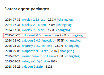

        Just one question: the website still shows the package version dated 2025-05-24 — is that correct?

          I was able to run the test a short while ago, and it turns out the version on the website is the same one I had already downloaded — it's not the corrected version.
          Would you be able to provide me with the link to the corrected one or update the link on the website?
            If there's no functional or code change, we don't change the version.However, this time we changed it's patch level. Try this one: https://pub.nxfilter.org/cxlogon-1.0.6-p2-win.msi
