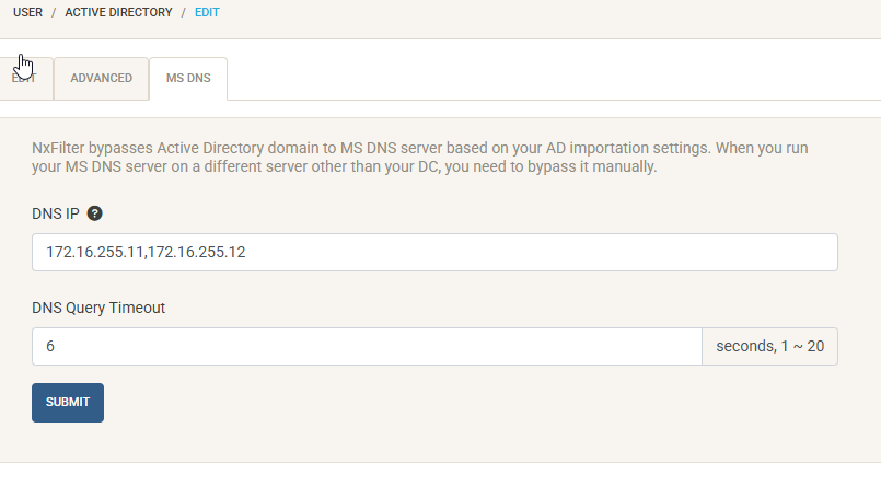

      Our MS DNS servers are also domain controllers. They are "correctly" configured in the import settings
Name:	2025-03-26 10_26_08-NxFilter v4.7.1.4.png
Name:	2025-03-26 10_26_38-NxFilter v4.7.1.4 .png
Name:	2025-03-26 10_27_08-NxFilter v4.7.1.4.png
