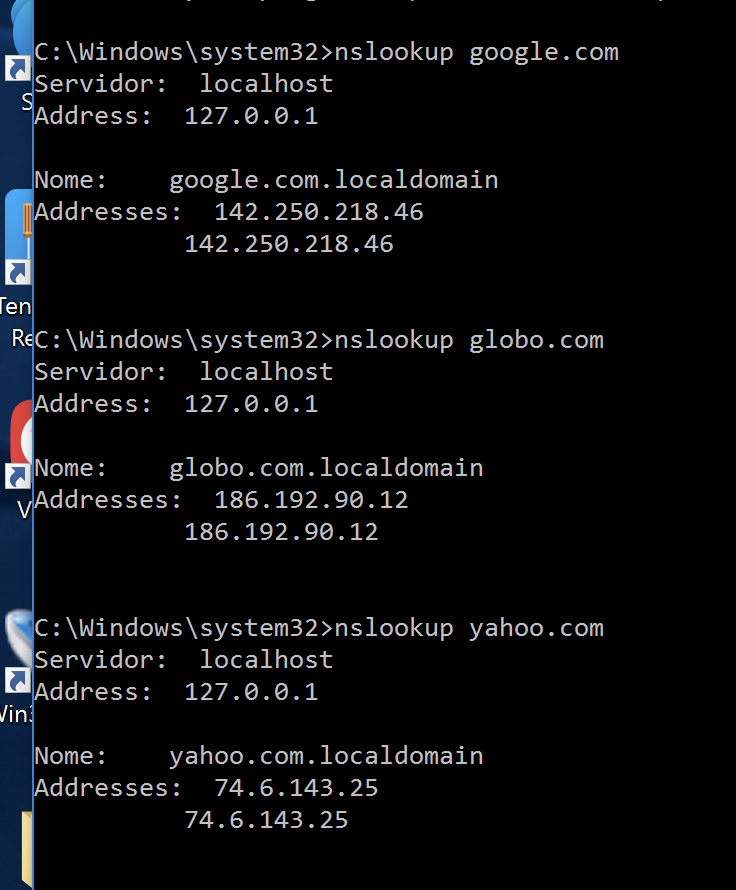

                Your service is not running with Admin account. It runs with another account. What's your DNS server IP? It tries to change your DNS settings every 15 seconds,
                Code:
                NFO [11-17 16:28:42] - LocalResolver.findLocalDnsIpByDhcp, New local DNS server = 8.8.8.8.
                INFO [11-17 16:28:43] - HandyMan.hijackDns, Updating DNS settings on Windows.
                Try this command on your CMD while your NxProxy running,
                Code:
                nslookup google.com
                And show me the result. Run the command while your NxProxy running.
                Here is the result attached.
