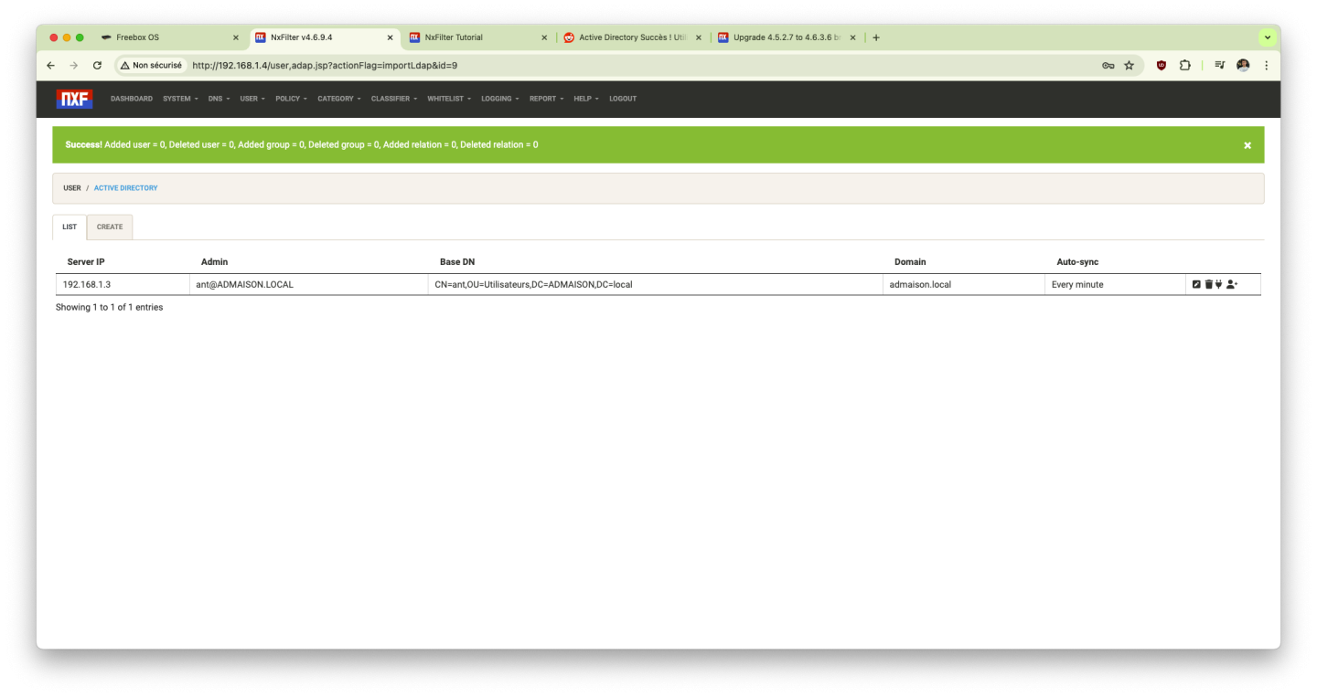

    Hello I want to add users to NX filter from active directory. I connect this with an admin account but when I want to import the rest, no element has been added.
    What is the procedure to follow? Did I do something wrong?
    Have a good day
    Users and groups should be in the OU in the base DN. You need to check with that first.
      Thank you for your response, I moved all of the user and group elements into Users but it gives the same result.
        Normally, when you don't do anything specific to your need, the base DN would look like 'cn=users,dc=nxfilter,dc=local'. But in your case, there are others. Are you sure that your users and groups are under the base DN in your setup? You may need to double check with an LDAP search tool like LdapAdmin http://www.ldapadmin.org/

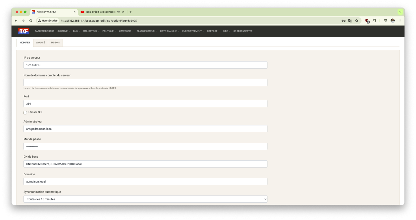

          Even after moving all the elements, which seems to be by default, it doesn't change anything. see Attachment
Name:	Capture d’écran 2024-04-28 à 13.43.16.png
ID:	2907 as much for me, it worked, I had to remove the CN=ant for my part (my user name in the DN
              Yeah, you don't need 'cn=ant' part. If you want to use OU then you have to place all the users and the groups you want to import in the OU.
