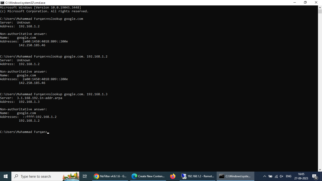

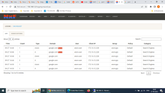

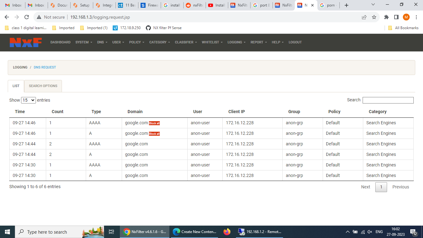

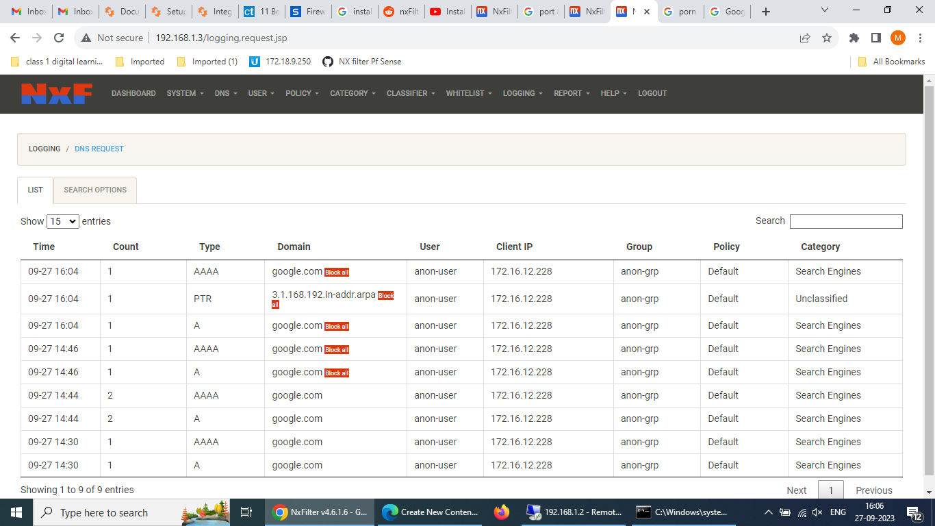

    I have installed Nxfilter on my domain where the active directory and DNS (192.168.1.2) services are running but the filtering is not done and no packet or user shows, steps are mentioned in this video link https://www.youtube.com/watch?v=v2iI...nnel=Jahastech
    i followed and configured this as per shown in the video.
    when i run the command like nslookup google.com no any traffic found on nxfilter while run nslookup google.com.192.168.1.3 (this is nxfilter IP)
    then shows the log in dns but no any filter traffic found

    Your system DNS IP is 192.168.0.2. You need to change it to 192.168.0.3 that is NxFilter. And your block redirection IP should be 192.168.0.3. You can change it on 'System > Setup'.
    And then you need to bypass your AD domain to 192.168.0.2. Read this, https://tutorial.nxfilter.org/c-acti...gration.php#ms
