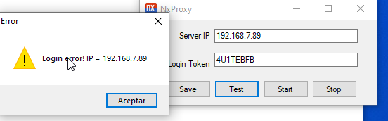

    I was wondering if someone could shed some light,
    Currently i have nxfilter installed on docker, and trying to install nxproxy on a windows machine, and i put the server IP which has the docker 192.168.7.89 and my windows machine another IP, i can ping it and access the webGUI so there is no issue on network
    but when i try test im getting this error see picture
    Thank you

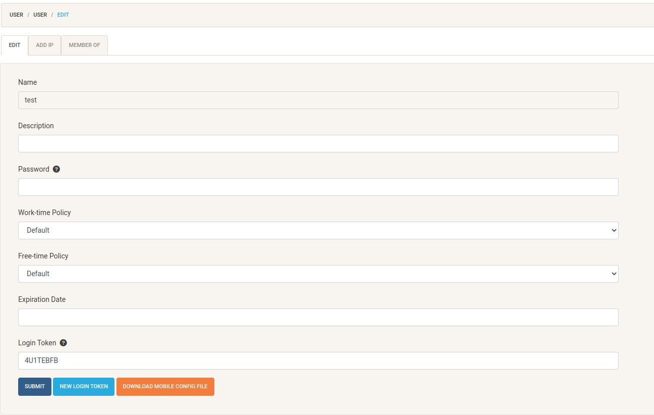

    You need to change Login Token to yours. Login Token is a user property. You can see it when you go to an edit page of a user.

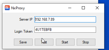

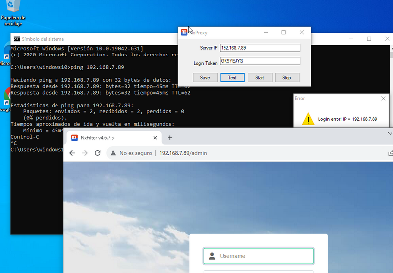

      Hi thanks for the reply, so i created the user with his login token but i keep getting the error
      i was checking the logs on the server side and i see this
      HTML Code:
      RHr, Login disabled for remote user! client IP = 192.168.21.45.
      Click image for larger version  Name:	image.png Views:	0 Size:	13.6 KB ID:	2316
      Click image for larger version  Name:	image.png Views:	0 Size:	34.0 KB ID:	2315
        Did you enable User Autentication on 'System > Setup'? If you already did it, look into /nxfilter/log/nxfilter.log when you do the test. You may need to enable debugging for NxFilter. https://tutorial.nxfilter.org/i-faq.php#enable-debug
          awsome that did the trick didnt know i had to check mark thank you again

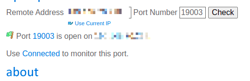

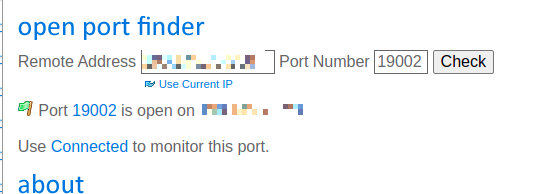

            i also opened the ports
            Thank you
              What do you mean by URL? You are supposed to use an IP or domain there. Try IP and see if it's working and then domain. If your domain doesn't work thry to ping it on cmd.
              • #8
                You also need to open TCP/443.
                • #9

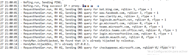

                  Thank you so much for the reply, whats odd is that it works the blocking,
                  currently this is what i have
                  192.168.7.147 192.168.7.89
                  nginx proxy---------nxfilter using port 8282
                  the NGINX proxy which has the SSL and is using 443 revese proxy into nxfilter 8282
                  i also tried IP same issue
                  very odd because on the logs it shows ping successful
