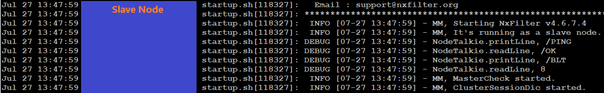

    The slave node shows this on startup:

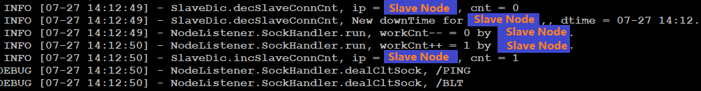

    The master node shows this:

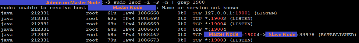

    I checked the ports on the master node and they were the following:

        I guess it should respond your qeury even if it has a problem with clustering. Then what's the last line of your slave node log? Just 'MasterCheck started' and hangs? In that case, you may need to add an entry for your master node on your slave node /etc/hosts file. https://tutorial.nxfilter.org/h-clus...xfilter.php#tr
          I added the entry in the host file but to no avail. Someone else on my team changed a some settings on the VMs it was running on and resolved the issue. They also discovered that only allowing TCP traffic over port 19004 will not allow clustering to function; 19004 needs to be opened for both TCP and UDP traffic.
