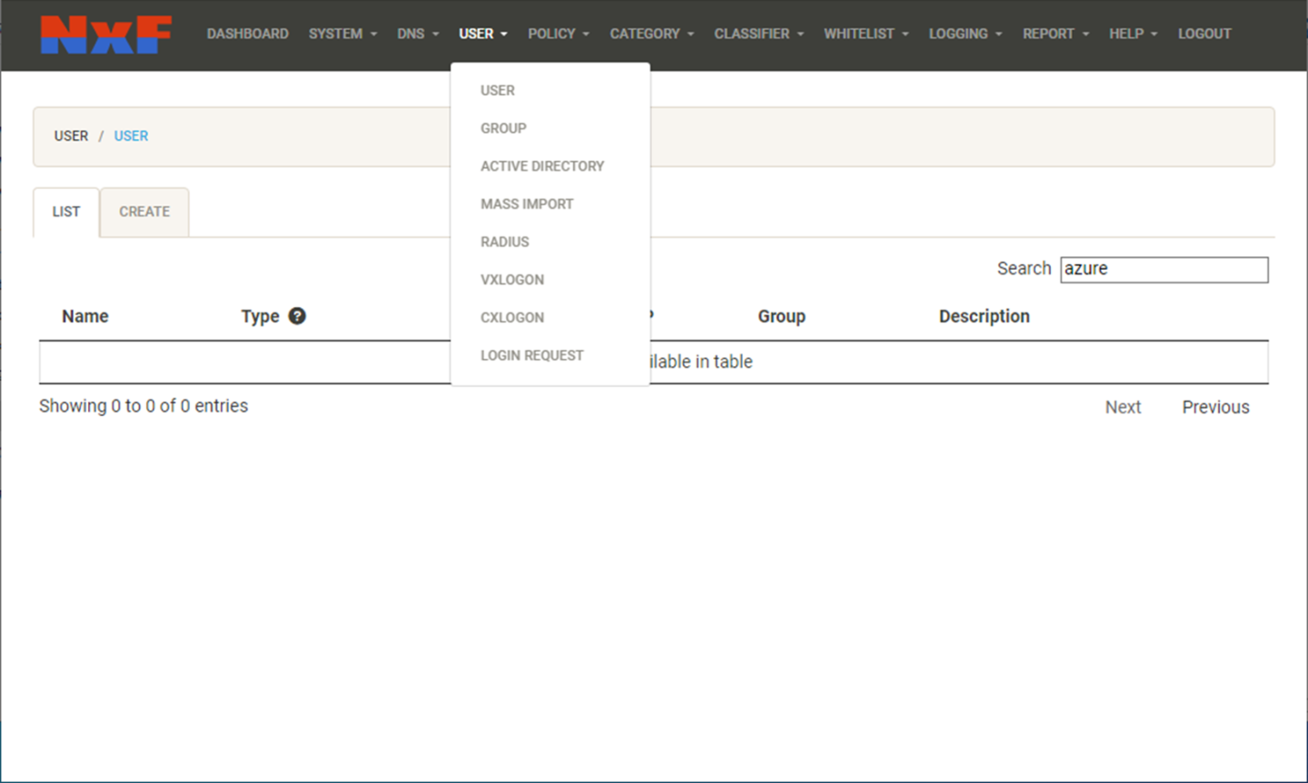

    I am interested in Nxfilter and want to use it in conjunction with Azure AD. I have extracted and installed nxfilter-4.6.6.3-azure.zip in Ubuntu in a Dcoker container and am running it.
    The admin center is working fine and I can access it, but when I register the app on Azure AD, create a secret, etc., and try to link it, the Azure Directry menu does not appear on the admin center.
    How can I make the Azure Directry menu appear in the Management Center?
    [Here is a screenshot]

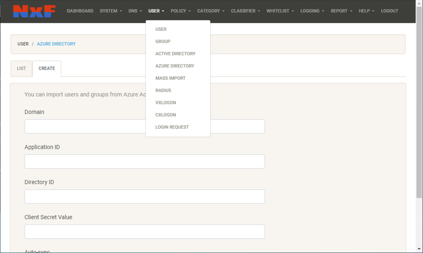

    Seems like there are some bugs for GUI of NxFilter for Azure AD. We will fix it today and upload it again.
      Try this one: http://pub.nxfilter.org/nxfilter-4.6.6.3-azure-p1.zip
        Thank you very much.
        I performed the installation from the Zip file you provided and the menu appears.
