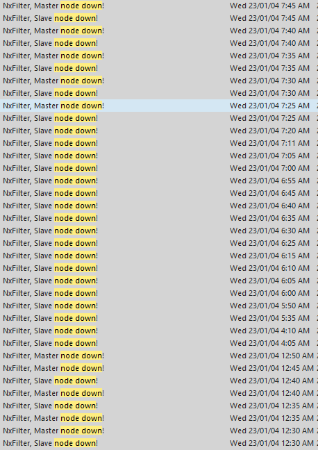

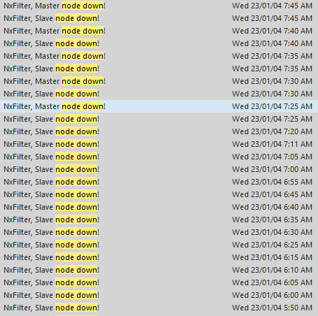

    After I performed the first NxFilter update after creating a Cluster, going from 4.6.4.1 to 4.6.4.3 and the following day to 4.6.4.5, I am receiving tons of incorrect Master/Slave Node Down emails and I am not sure how to stop the emails. We have NxFilter installed on Linux Mint and both are up and running just fine. We have this line "cluster_double_check = 1" in the cfg.properties file. Below I have some log information, I have received 150 emails as of 12:00 AM. At 7:45 AM I received the last email about the Slave being down at 7:15 AM, I received this same email every 5 minutes starting at 7:20 AM. All this time our Slave Node was up and running, which was also seen in the Cluster section of the Master Node. I also receive emails from the Slave Node with ""Cluster master node down at null"

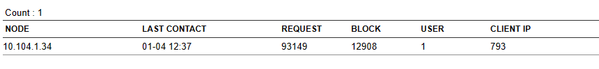

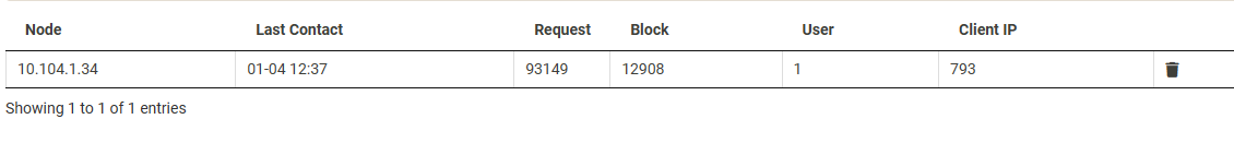

      Yes, it's up and running the whole time. I should have taken screen shots of the Master and Slave Cluster pages, but I forgot to do that.

            Yes, I get them boh, but more Slave Node than Master Node, the Master Node emails says "Cluster master node down at null". The last one is at 7:45, but it will start up again after taking a "break". Last night the last one was at 12:50 AM, then it didn't start up again after 4:05 AM. I've created the cluster on December 2 and it has been running fine (no Node Down emails) until I did the update 2 days ago.

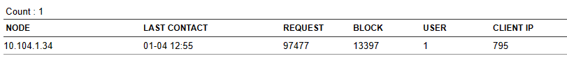

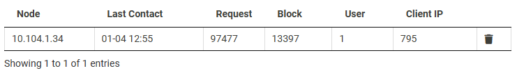

                I got some screen shots now. I received an email at 12:55, 13:00, 13:05, and 13:10 stating "Cluster slave node down at 01-04 12:50, 10.104.1.34", yet the screen shots below (the first is from the Master, the 2nd from the Slave) show that it is up in NxFilter at 12:55, so why 3 more emails that it was down at 12:50???:

                  So, you still get those emails even if your slave running and you see the Last Contact from the slave gets updated?
                  • #10
                    Yes, indeed, even in NxFilter Dashboard you can see that they are connected, yet it keeps sending emails. After I posted my message I received another wave of emails, it drove me nuts, so I turned them off (I wrote an Outlook Inbox Rule) and we are now checking their status with Nagios instead. Nagios performs a DNS query every 5 minutes and lets me know if they are not responding, so in a way I've created my own fix.
