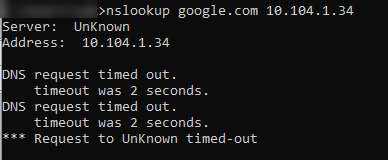

          When you do 'nslookup google.com' to your slave node what do you get? Your block redirection IP? Then it may not be able to reach out its Cloudlist server. Do you have any firewall rule for your slave node?
            The first screen shot shows the command window, the second screen shot shows the request on the Master. Both running on Linux with default (untouched) firewall settings, whatever that is on Linux.

              It means that it doesn't resolve. Your client sent a DNS query and your slave node (10.104.1.34) received the query and it processed it and logged it but your client couldn't get any response. You need to find out where's the problem.
              You can try to do 'nslookup google.com' from your slave node system. If there's no problem on the same system, there's something between 10.104.1.34 and 10.100.10.43. If you get the same problem then your slave node might have some problem with DNS resolving.
