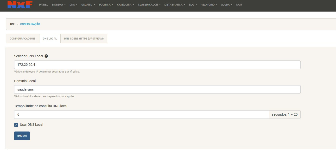

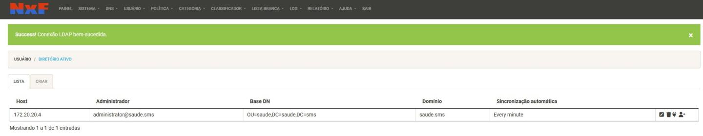

              • It's done by your AD importation setup automatically. If it doesn't work then you do it manually. Read this, https://tutorial.nxfilter.org/c-acti...gration.php#ms
                172.20.20.4 is your MS DNS IP? And is it your DC IP as well? If so, NxFilter tries to bypass your AD domain to 172.20.20.4 automatically.
                If there's something different in your AD settings, NxFilter can't find your domain or your MS DNS server.
                If I guess it based on the image you posted,
                Local DNS : 172.20.20.4
                Local Domain : saude.sms,20.20.172.in-addr.arpa,22.20.172.in-addr.arpa

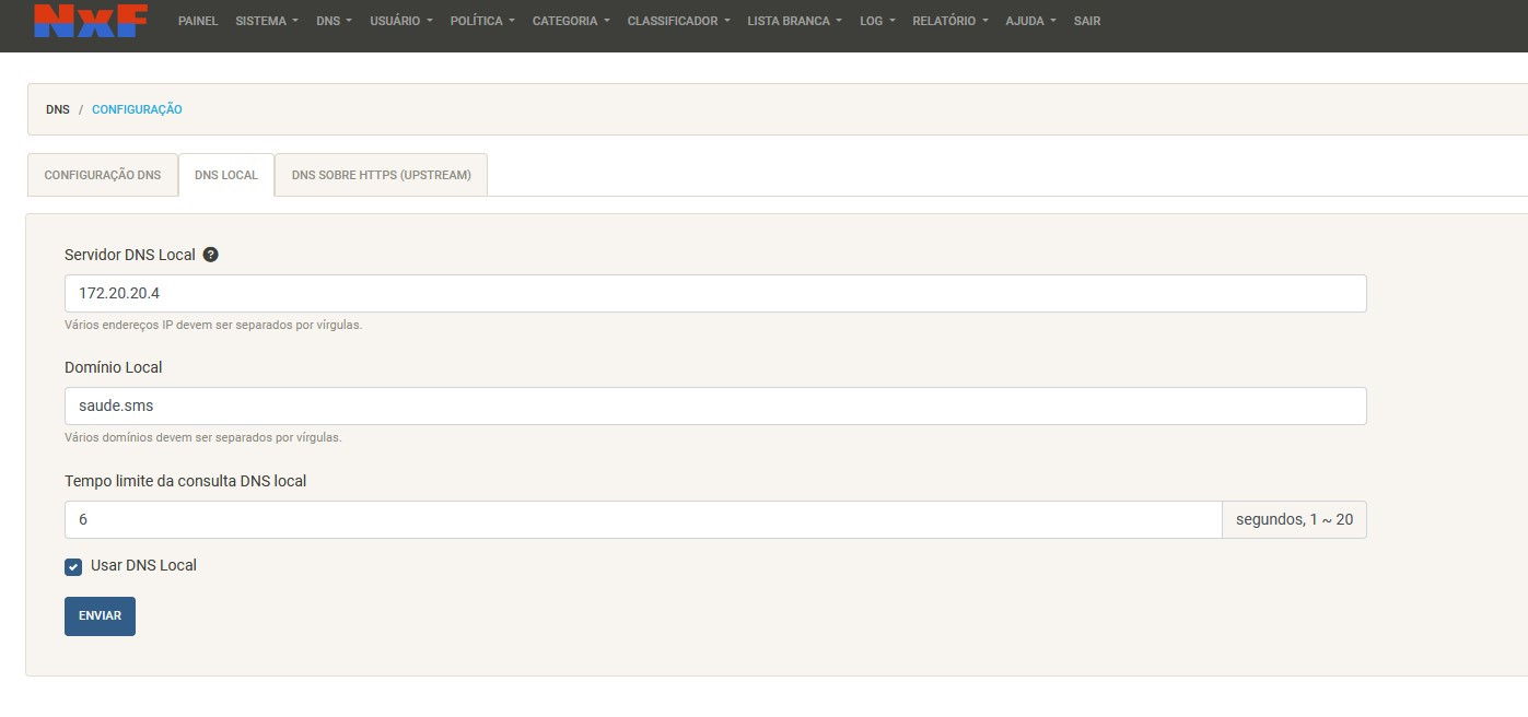

                  Yes, 172.20.20.4 it's my DC and DNS, my nxfilter is 172.20.20.2 windows 10 machine. If I point a client DNS to 172.20.20.2 today, they can't resolve saude.sms (172.20.20.4)... and the settings in nxfilter are ok, I guess:

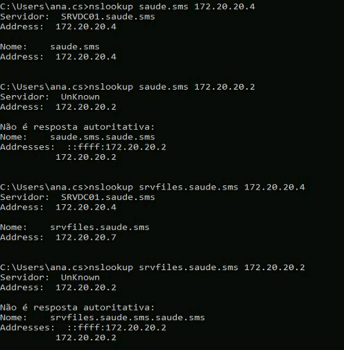

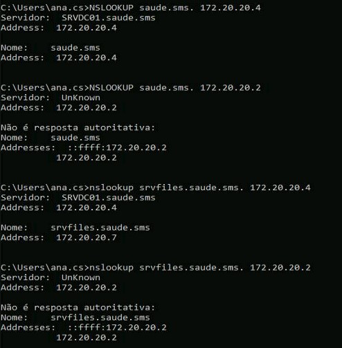

                  • What did you get when you nslookup for saude.sms then? Try both of these,
                    Code:
                    nslookup saude.sms 172.20.20.4
                    nslookup saude.sms 172.20.20.2
                    And try these as well,
                    Code:
                    nslookup srvfiles.saude.sms 172.20.20.4
                    nslookup srvfiles.saude.sms 172.20.20.2

                      • Originally posted by support200 View Post
                        Code:
                        Code:

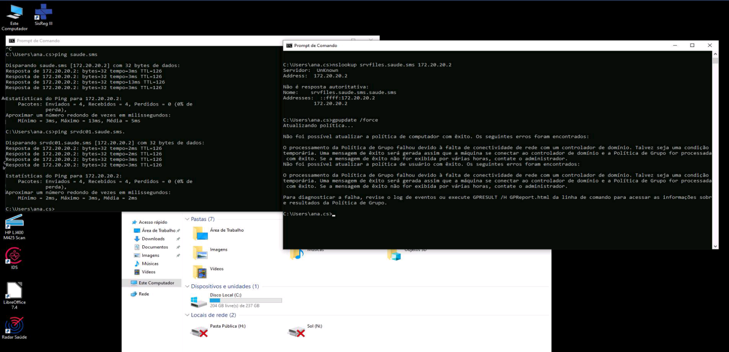

                        Client DNS set to 172.20.20.2
                        • it seems that the client could resolve the FQDN, but doesn't map drives, fail to update the GPOs
                          Click image for larger version  Name:	image.png Views:	0 Size:	558.8 KB ID:	1512
                          • So, you get NxFilter IP as the answer. Right? Then you need to know why. Did you enable debugging? You could get it by block redirection or auth redirection. When you enable debugging, you can see what it is in your log file.
                            And when you do nslookup next time add '.' at the end of the queried domain to prevent your system adding its domain like 'saude.sms.saude.sms'.
                            Did you add that reverse lookup domains into your Local Domain? For dynamic update, you should bypass them as well. i don't know if it's related to your GPO problem though.

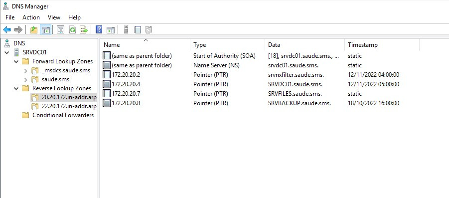

                              Yes, enabled debbug, but I can't found nothing special...

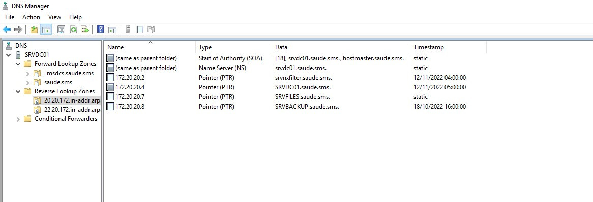

                              On reverse lookup it's ok, don't even remeber but I think this records were added automatically except the SRVFILES

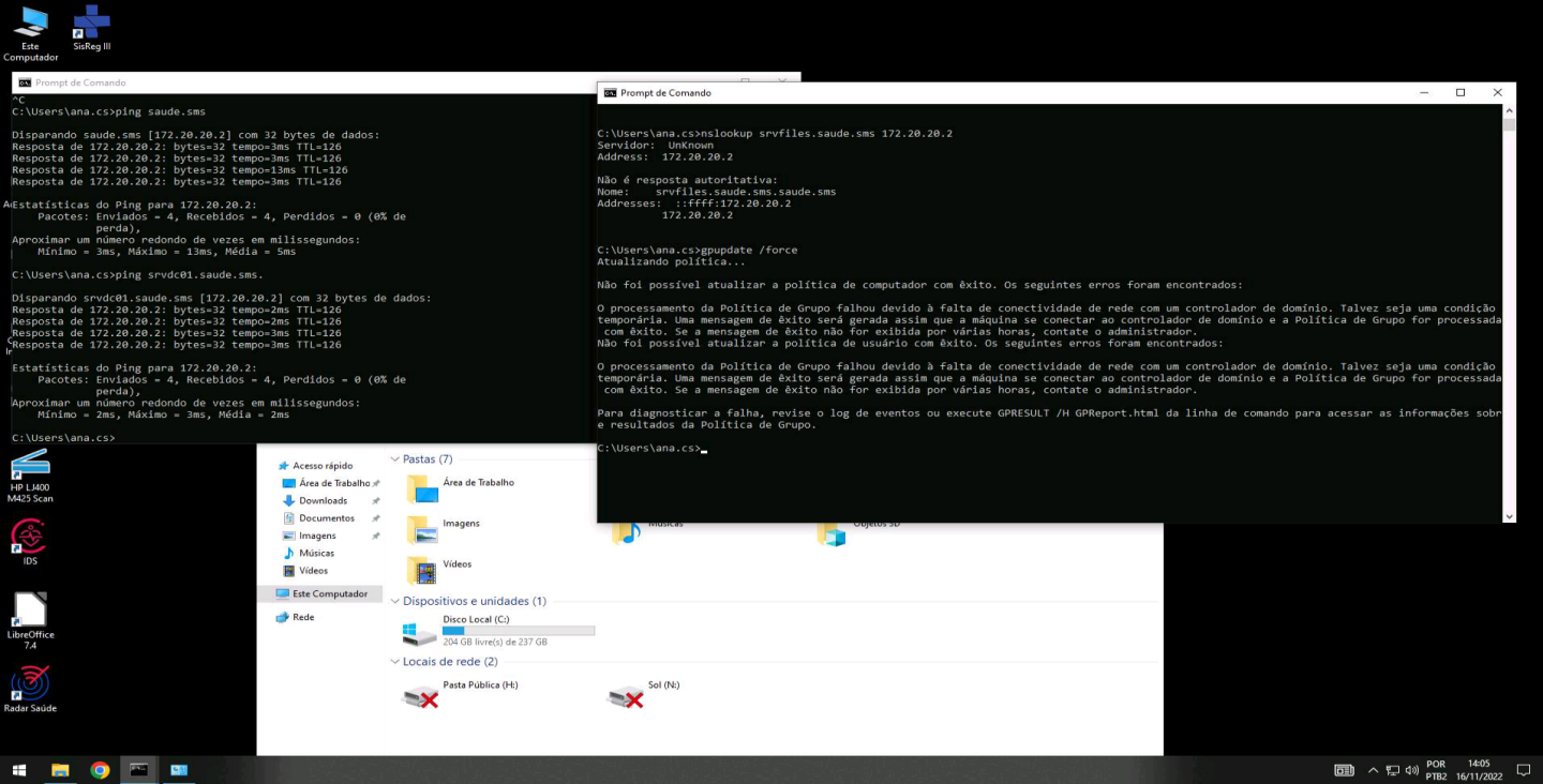

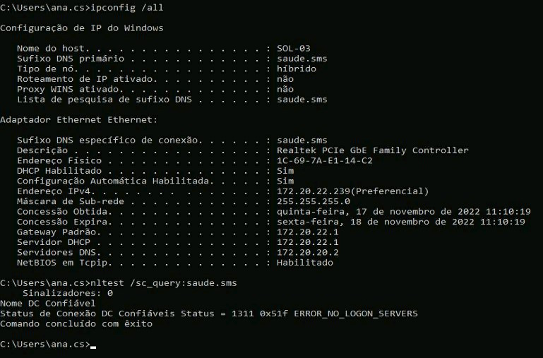

                              On client nslookup seems to be ok! but when I execute a comand to test connection to DC, it fails...
