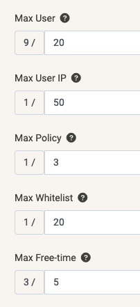

    With NxRelay, you can see the number of private IPs and usernames behind a router. How many local IPs for your operator on 'Report > Operator Stats'?
      Click image for larger version  Name:	image.png Views:	0 Size:	33.1 KB ID:	1430Looks like 22 IPs. I have it limited to 50.
        No. You have it limited to 20. It's Max User. Max User IP is about how many IP associations an operator can make.

            Max User is for license counting. When you don't know how many users behind a router NxCloud counts DNS requests but you use NxRelay and now you know how many users behind a router. Then we count usernames or private IPs.
            Max User 20 means, the operator can make 60k request a day. 20 x 3000 = 60k. And the warning message for license violation by request counting is 'Too many requests' in my memory.
            Maybe we should remove that Max User IP. It was there to prevent IP collision by operators. But it's confusing when you use NxRelay.

                  Support200, I sent you the logs and additional questions. I'm posting here for the record if anyone else is looking for this question. The error log shows:
                  INFO [10-25 22:44:08] - RHiAD, User overflow by local client IP count, operator = <operator>, IP count = 22.
                  So, it looks like you are not just counting the number of dns requests against NXCloud but also counting the individual local IPs sent by the Relay. I have IPs set to 50 but clearly that doesn't have an affect. Only when I increased my max users over 20 did it clear and properly respond to the DNS requests.

                    Read the previous postings again. I already told you that NxRelay counts local IPs. When you don't know the number of local IPs then it counts DNS requests. But you use NxRelay and you know the number of local IPs then you know the exact number of users behind a router. That's one of the purposes of using NxRelay.
                    I also told you Max User IP is about the number of IP association for an operator. It's not for User Counting. It's there to prevent IP collision by operators.
