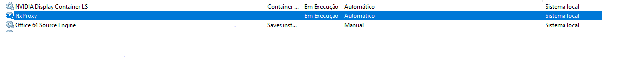

    • Click image for larger version
      Estou usando:
      cmd:
      net stop NxProxy
      net start NxProxy
      Powershell:
      powershell -command "Restart-Service NxProxy -Force"
