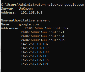

    Do this on the CMD of one of those 3 PCs.
    Code:
    nslookup google.com
    And show me the result.
      Code:
      nslookup google.com
      This is what I get.
        Seems like your setup is OK. You stil don't see any traffic from the PC on 'Logging > Request'?
          I randomly see one or two requests but not anything related to websites that I've blocked. I can access the websites that i've blocked. This works fine for my own PC that I've been testing the rules and stuff but not in others.
